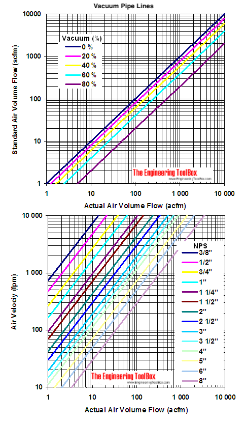

Air velocity diagrams for vacuum pipe lines.
Air velocities in vacuum pipes can be estimated with the diagrams below.
Standard and Actual Air Volume - cfm
vacuum pipes - air velocity diagram - cfm
Download and print Vacuum Pipe Line - Velocity vs. Fow Chart
The diagram is calculated for steel pipes schedule 40.

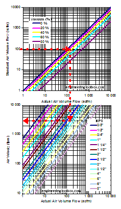

Example - Estimating the Vacuum Air Flow Velocity
Velocity in a NPS 3" steel pipe with standard air volume flow 100 scfm at 30% vacuum can be estimated to approximately 3000 fpm as indicated in the diagram below:
vacuum pipe air velocity diagram example
