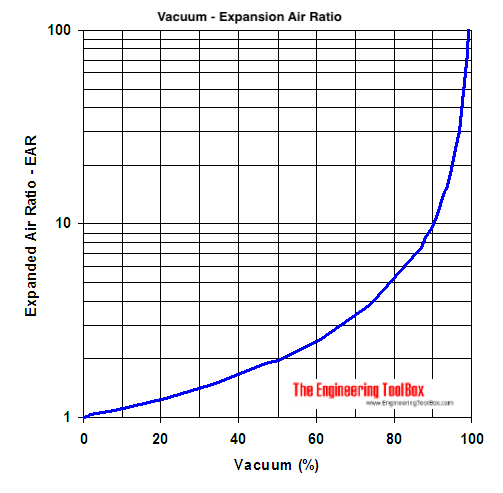

Expanded air ratio for temperatures 60 oF (15.5 oC) are indicated in the diagram below:
vacuum - expanded air ratio - diagram
The diagram above can be used to calculate air flow in SI-units where
  • actual air flow - al/s
  • standard air flow - sl/s
Example -  Vacuum Expansion of Air
From the table above the expansion ratio of air from atmospheric pressure to 50% vacuum is 2
