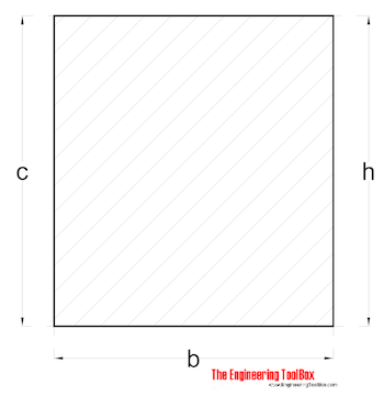

Rectangle - with axis in center
Radius of Gyration - Rectangular Section with axis in center
Radius of Gyration for a rectangle with axis in center can be calculated as
rmax = 0.289 h                                (1)
rmax = max radius of gyration (strong axis moment of inertia)

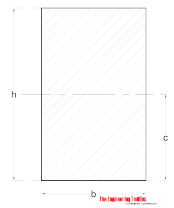

Rectangle - with excentric axis
Radius of Gyration - Rectangular Section with excentric axis
Radius of Gyration for a rectangle with excentric axis can be calculated as
r = 0.577 h                                (2)

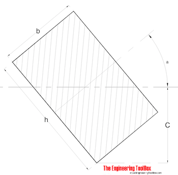

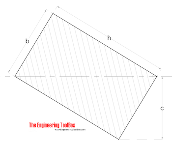

Rectangle - with tilted axis
Radius of Gyration - Rectangular Section with tilted axis
Radius of Gyration for a rectangle with tilted axis can be calculated as
r = b h / (6 (b2 + h2))1/2                                (3)
Rectangle - with tilted axis II
r = (((h2 + cos2(a)) + (b2 sin2(a))) / 12)1/2                                (4)

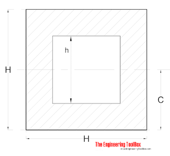

Hollow Square
Radius of Gyration - Hollow Square
Radius of Gyration for a hollow square can be calculated as
r = ((H2 + h2) / 12)1/2                                (5)

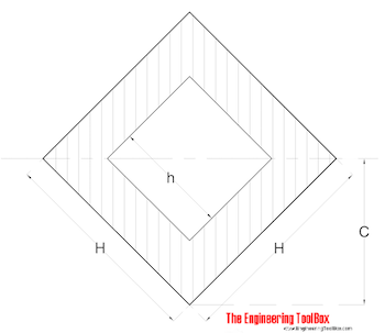

Hollow Square - with tilted axis
Radius of Gyration - Hollow Square with tilted axis
Radius of Gyration for a hollow square with tilted axis can be calculated as
r = ((H2 + h2) / 12)1/2                                (6)

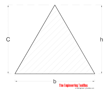

Equilateral Triangle with excentric axis
Radius of Gyration - Equilateral Triangle
Radius of Gyration for a equilateral triangle can be calculated as
r = h / (18)1/2                                (7)

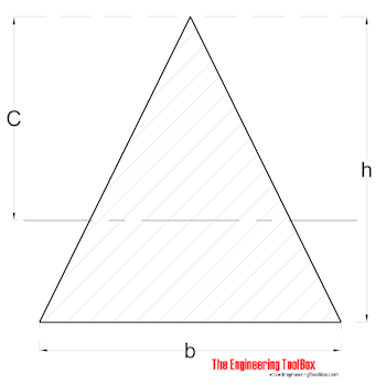

Triangle
Radius of Gyration - Triangle
r = h / (6)1/2                                (8)
