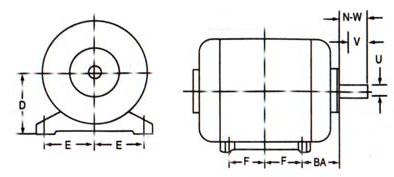

Electrical Motors - Frame Dimensions
Electrical motors NEMA frame dimensions.
Dimensions of electrical motor frames according NEMA 1984 are indicated below:
- 1 in (inch) = 25.4 mm
| NEMA Frame Designation | Frame Dimensions (inches) | ||||||
| D | E | 2F | BA | N-W | V | U | |
