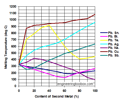

Lead - Pb
Melting points of Pb - Lead - in mixtures with
  • Sn - Tin
  • Bi - Bismuth
  • Te - Tellurium
  • Ag - Silver
  • Na - Sodium - Natrium
  • Cu - Copper
  • Sb - Antimony
Lead (Pb) alloys - melting points diagram

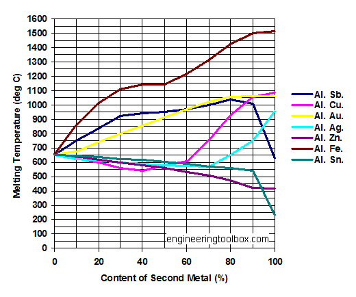

Aluminum - Al
Melting points of Al - Aluminum - in mixtures with
  • Sb - Antimony
  • Cu - Copper
  • Au - Gold
  • Ag - Silver
  • Zn - Zinc
  • Fe - Iron
  • Sn - Tin
Aluminum (Al) alloys - melting points diagram

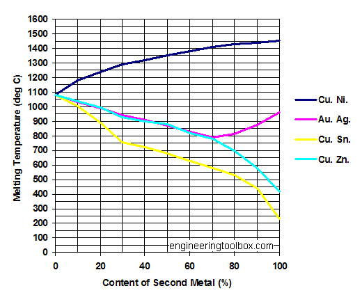

Copper - Cu
Melting points of Cu - Copper - in mixtures with
  • Ni - Nickel
  • Ag - Silver
  • Sn - Tin
  • Zn - Zinc
Copper (Cu) alloys - melting points diagram

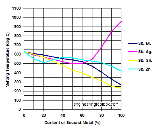

Antimony - Sb
Melting points of Sb - Antimony - in mixtures with
  • Bi - Bismuth
  • Ag - Silver
  • Sn - Tin
  • Zn - Zinc
Antimony (Sb) alloys - melting points diagram
