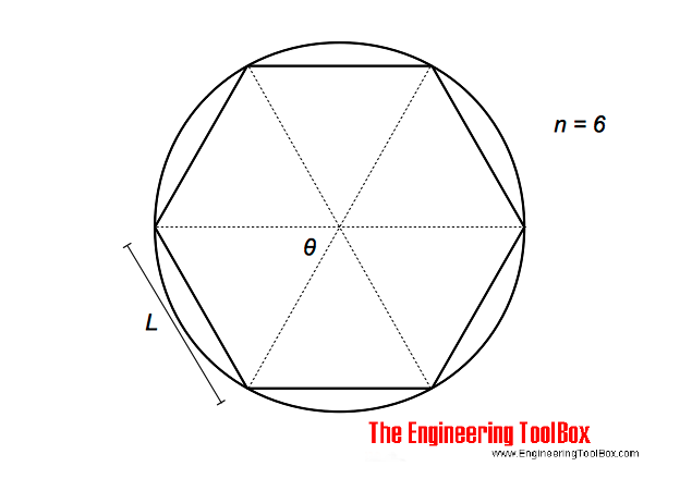

Circle - the Chord Lengths when Divided in to Equal Segments
Calculate chord lengths when dividing the circumference of a circle into an equal number of segments.
Chord Length Calculator
The length - L - of a chord when dividing a circumference of a circle into equal number of segments can be calculated from the table below. The chord length - L - in the table is for a "unit circle" with radius = 1.
To calculate the actual length of a chord - multiply the "unit circle" length - L - with the radius for the the actual circle.
