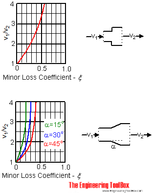

Minor Loss Coefficients - Expansions
minor loss coefficients diagram - expansions
