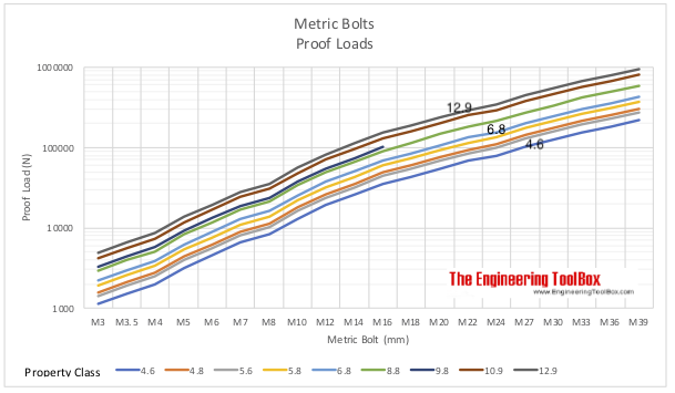

Proof Load
Proof load is defined as the maximum tensile force that can be applied to a bolt that will not result in plastic deformation. A material must remain in its elastic region when loaded up to its proof load typically between 85-95% of the yield strength. Acceptable clamp load is typically 75% of proof load.
For full table with more Property Classes - rotate the screen!
| Thread d (mm) | Pitch P (mm) | Nominal Stress Area As,nom (mm2) | Property Class | ||||||||
| 4.6 | 4.8 | 5.6 | 5.8 | 6.8 | 8.8 | 9.8 | 10.9 | 12.9 | |||
| Proof Load - Fp (N) | |||||||||||
| M3 | 0.50 | 5.03 | 1130 | 1560 | 1410 | 1910 | 2210 | 2920 | 3270 | 4180 | 4880 |
| M3.5 | 0.60 | 6.78 | 1530 | 2100 | 1900 | 2580 | 2980 | 3940 | 4410 | 5630 | 6580 |
| M4 | 0.70 | 8.78 | 1980 | 2770 | 2460 | 3340 | 3860 | 5100 | 5710 | 7290 | 8520 |
| M5 | 0.80 | 14.2 | 3200 | 4400 | 3980 | 5400 | 6250 | 8230 | 9230 | 11800 | 13800 |
| M6 | 1.00 | 20.1 | 4520 | 6230 | 5630 | 7640 | 8840 | 11600 | 13100 | 16700 | 19500 |
| M7 | 1.00 | 28.9 | 6500 | 8920 | 8090 | 11000 | 12700 | 16800 | 18800 | 24000 | 28000 |
| M8 | 1.25 | 36.6 | 8240 | 11400 | 10200 | 13900 | 16100 | 21200 | 23800 | 30400 | 35500 |
| M10 | 1.50 | 58.0 | 13000 | 18000 | 16200 | 22000 | 25500 | 33700 | 37700 | 48100 | 56300 |
| M12 | 1.75 | 84.3 | 19000 | 26100 | 23600 | 32000 | 37100 | 48900d) | 54800 | 70000 | 81800 |
| M14 | 2.00 | 115 | 25900 | 35600 | 32200 | 43700 | 50600 | 66700d) | 74800 | 95500 | 112000 |
| M16 | 2.00 | 157 | 35300 | 48700 | 44000 | 59700 | 69100 | 91000d) | 102000 | 130000 | 152000 |
| M18 | 2.50 | 192 | 43200 | 59500 | 53800 | 73000 | 84500 | 115000 | 159000 | 186000 | |
| M20 | 2.50 | 245 | 55100 | 76000 | 68600 | 93100 | 108000 | 147000 | 203000 | 238000 | |
| M22 | 2.50 | 303 | 68200 | 93900 | 84800 | 115000 | 133000 | 182000 | 252000 | 294000 | |
| M24 | 3.00 | 353 | 79400 | 109000 | 98800 | 134000 | 155000 | 212000 | 293000 | 342000 | |
| M27 | 3.00 | 459 | 103000 | 142000 | 128000 | 174000 | 202000 | 275000 | 381000 | 445000 | |
| M30 | 3.50 | 561 | 126000 | 174000 | 157000 | 213000 | 247000 | 337000 | 466000 | 544000 | |
| M33 | 3.50 | 694 | 156000 | 215000 | 194000 | 264000 | 305000 | 416000 | 570000 | 673000 | |
| M36 | 4.00 | 817 | 184000 | 253000 | 229000 | 310000 | 359000 | 490000 | 678000 | 792000 | |
| M39 | 4.00 | 976 | 220000 | 303000 | 273000 | 371000 | 429000 | 586000 | 810000 | 947000 | |
d) For structural bolting: 50700 N (M12), 68800 N (M14) and 94500 N (M16)
