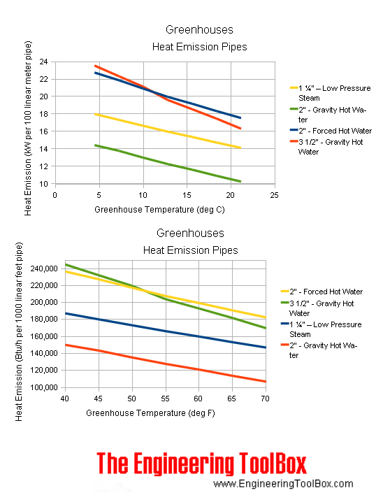

Heat emission from steam and hot water pipes typical used in greenhouse installations.
Heat emmission from
  • low pressure steam
  • gravity hot water
  • forced hot water
pipes used in heated spaces, typical greenhouses, are indicated below:
Heat emission from pipes in greenhouses
