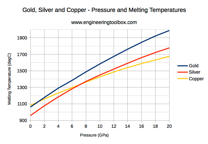

Gold, Silver and Copper - Pressure and Melting Temperatures
Gold, silver and copper - melting temperatures vs. pressure
