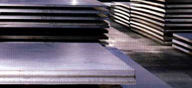

Steel sheets and plates are typical stocked in 36”, 48”, and 60” widths and 96”, 120”, and 144” lengths.
Example - Weight of Steel Plate
The weight of a 1 inch thick 36" (3 ft) x 96" (8 ft) steel plate with weight 40.8 lb/ft2 (from table above) can be calculated as
W = (40.8 lb/ft2) (3 ft) (8 ft)
= 979 lb

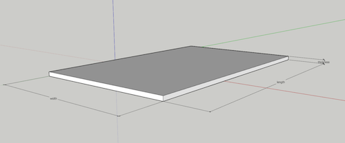

Calculating Steel Plate Weight
Weight per sq. feet of hot rolled mild steel plates can be calculated as
W = 40.8 t                         (1)
W = weight of steel plate (lb/ft2)
t = plate thickness (in)
Steel plate - thickness and weight
Insert 3D components with the Engineering ToolBox Sketchup Extension
