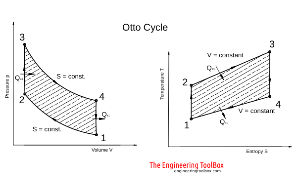

Otto Cycle
otto cycle
The Otto cycle is a contant-volume cycle where addition of heat or combustion takes place isochorically.
Heat addition and heat rejection occur isothermally in the cycle between point 2 and 3, and 4 and 1.
The efficiency of the Otto cycle can be calculated as
μ = 1 - ε(1 - κ)        (2)
μ =  efficiency (0.. 1)
ε = compression ratio
κ = isentropic exponent

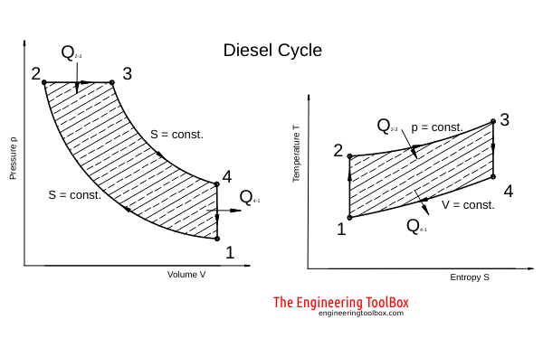

Diesel Cycle
diesel cycle
The Diesel cycle is a constant-pressure cycle where the addition of heat and combustion takes place isobaric.
Heat addition and heat rejection occur isothermic in the cycle between point 2 and 3,  and 4 and 1.
The efficiency of the Diesel cycle can be calculated as
μ = 1 - (Φκ - 1) / (ε(κ - 1) κ (Φ - 1) )      (3)
Φ = injection ratio

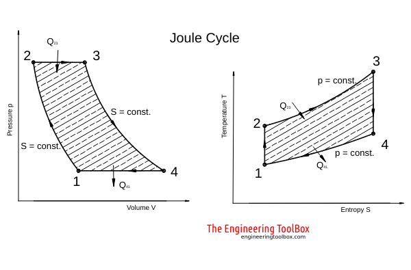

Joule Cycle
joule cycle
The Joule cycle is a comparison cycle for gas turbines with continuous flow.
The efficiency can be calculated as
η = 1 - T1 / T2                             (4)
