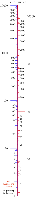

cfm to m3/h Converter
cfm to m3/h converter
Download and print cfm to m3/h Converter!

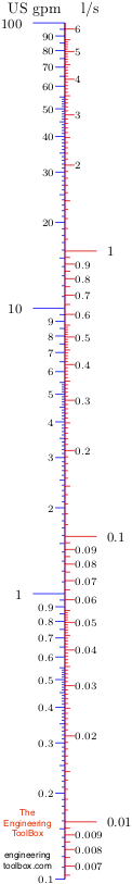

US gpm to l/s Converter
US gpm to l/s  converter
Download and print U.S. gpm to l/s Converter!
