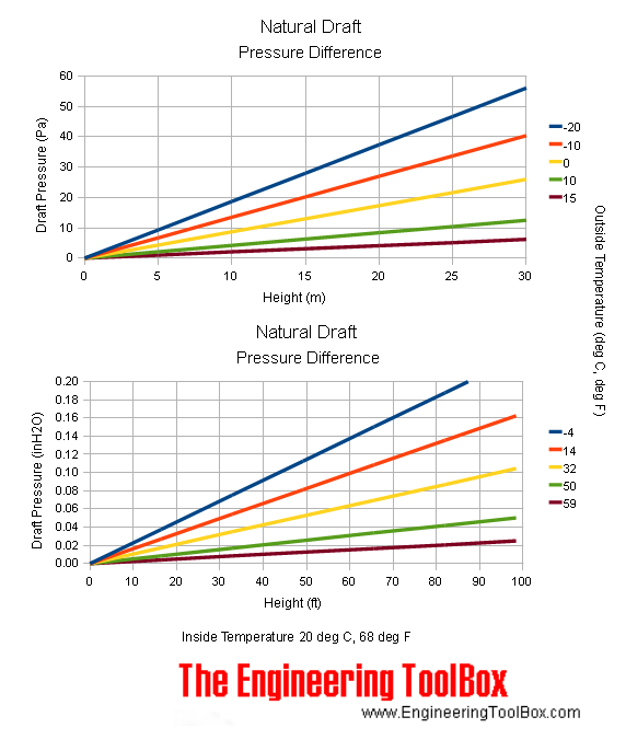

Natural Draft Chart - SI and Imperial Units
Natural draft chart - imperial and metric units
