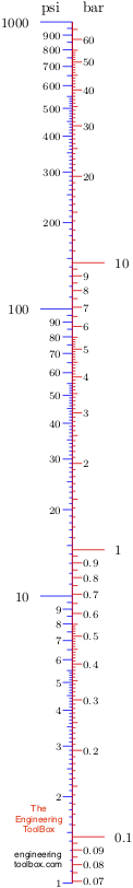

psi to bar Nomogram
psi to bar converter
Download and print psi to bar Converter!

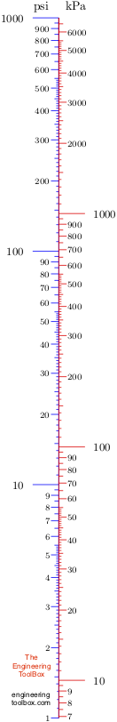

psi to kPa Nomogram
psi to kPa converter
Download and print psi to kPa Converter!
